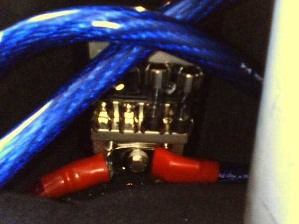

Sunday, December 03, 2006 - 05:22 GMT Dry Cell The two wires on the very bottom are from the (+) of the batts.. one on the left if from under the hood and the one on the right is from the one in the trunk.. and yes there is a lot of wiring.. i hooked it up the day of the comp.. then went right back to the hospital and i've been too lazy since to redo wiring/

Sunday, December 03, 2006 - 05:23 GMT and sorry chad.. another cell phone picture .. dead batteries in my digi cam

Sunday, December 03, 2006 - 05:29 GMT What gauge is that wire Kev
Username: James1115 Ct
Post Number: 7552 Registered: Dec-04
Sunday, December 03, 2006 - 05:30 GMT looks like 0
Username: Frkkevin Resonant Engineering...,
Fort Worth...
Email
Post Number: 1988 Registered: Nov-05
Sunday, December 03, 2006 - 05:34 GMT Hooker 1/0awg
