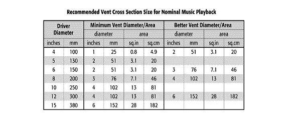

hey Marshall - what was ur port area to cuft ratio again ?
i seen u post it a few times b4 but cant remember it offhand but u said 10-16sq inches / cuft ? which site did u see this or is this with ur experience ?
was this for SPL tuning only ?
i normally calculate it using T/S but i would still like to know a average port area thats good 4 SQL no matter what the sub is ....

hmmm - after some searching i found back this
sensible comments from any1 welcomed .....

I just learned over time to use 12-16sq inches per cuft in 90% of daily installs.
If you are going w/ a low power install...say a 12" w/ 200wrms in 2cuft net...24sq inches of port is fine.
The more power used, the more port I use.
