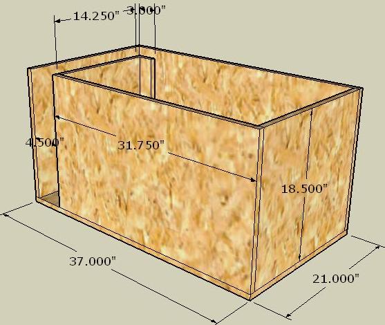

hey i got a trunk space of 37x20x20 i should be able to get a 6 cube box back there for the 18 ill be buying its a re sx and i want it tuned to 35hz and the sub on top and port in the back so if you can build the box on subwoofer tools and does it matter if i just stick the sub on top instead of the front like it shows on subwoofer tools help me please last question on a box i just need this one

Box - 20.0x37.0x20.0
Vent - 18.5x4.0x28.0
Will be tuned to 35hz and have roughly 5.1cu.ft volume after displacement..

so when i go back with the port of the 28inches go back until 4" of the back wall and resume with the remainder inches going right?

here ya go...
5.9cuft (after sub and port displacments) tuned to 35hz
put a 37"x21" board on to of it and mount the sub.
box outside deminsions: 37"x21"x20"

port is 4.5" x 18.5".

before you build it make sure you can get it in there! lol. lots of people measure the interior of the trunk but they dont measure the trunk opening.

Username: Boomtank
Post Number: 113
Marshall what did u use to design that box pix. Subtools? where do u find that.
Username: Frkkevin
Post Number: 1599
that is google sketch up.. i think he uses win ISD unless he ever got a copy of bbp6.. which i can still send you marshall :-)
