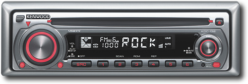

Need help..have one rca jack in my head unit how do i hook up 2 amps? is there a way too convert another one?
Username: Metalfreak760
Ca Usa
i have a kenwood head unit and i need two amps hooked up. 1 for sound the other for bass and i was wondering if they make something that i can split two amps with my 1 rca jack in the back of my head unit? well if u know what im talking about and have a pic of what i need or something please let me know i really need one...also does anyone know if a bazooka will fit a 87 toyota pickup truck? its a single cab so there isnt much room...here is my head unit..Upload

usually amps have rca hookups so you can hook up another amp to that one, that how I did my system, is I hooked up amp to amp and set one for low pass, and the other for high pass.

well is that what the rca jack on the amp that one says in and the other says out...so do u hook up the other amp too the out? that would be nice but i need a wire too go to the battery..is there anything i can buy that will let me split the wire from the amp instead of going all the way too the battery?

Buy another head unit and install them both. one for bass, one for sound.
Or get RCA Y splitters. And yes, just jump the rem from one amp to the next.

you mean do you need to run another power wire from the battery back to the second amp? if that was your questions, the answer is no. all you need is a distribution block. also, use another distribution block for the ground, and use just one grounding point in your car.

Post Number: 77
