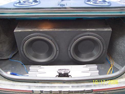

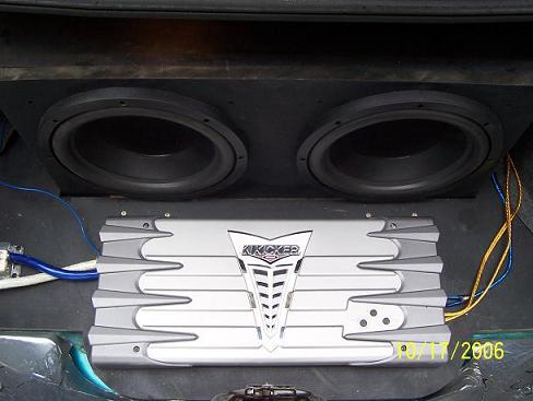

here it is....far from perfect. im still working on finishing it up.
Username: Logan__tille
Hamilton, Indiana United states
Post Number: 1849
nice. hows it sound?
Post Number: 1850
clean up some of the wires though.lol

AMP: Kicker kx1200.1, 1440 rms @ 1 ohm
SUBS: 12" Ascendant Audio Arsenals 750rms each

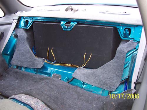

BOX: sealed, 2 chamber, 2.06 square Ft. NET per chamber (made myself ;])
Sound Deadening: EDEAD vise 2
sounded ok at first but once i put in that edead, it sounds awesome

Username: Basshead86
Try Google
Post Number: 7196
Registered: Aug-05
how do you like those Arsenals?
they sure do look nice.:-)

look's nice bud how does it sound?
Username: Bayrent88
Ingleside, Texas USA
Post Number: 67
i would of faced the sub into the car though...but thats just me
Try Google
Post Number: 7219
Registered: Aug-05
sounds better/louder with the subs soundwaves resonating in the trunk:-)

i dont know why but to me it sounds better with subs facing in i dont like all the rattling in the back when its bouncing off everything maybe its just me.

i'd face the subs in to the cabin too. box that big, it would be easy to seal the sides. you would gain alot more spl that way. if you don't believe me then just try it please. you'll know what i am talking about.

normaly i too would say face backwards but from the pix it seems like the size of that box will block most or the waves resonating back into the car - but try facing it 4ward with the box far back as possible & let us know if the sound improves
only way 2 know is 2 actually try it ..........

alright...ill try it sometime...but its a real tight fit.....i had to raise my 6x9s just to fit a 14 1/2" box in there!!! i had to put it in through the back seat opening and its just really alkward. got to have atleast 2 people.

OK. I did it today : turned my box around and did a few other thing....eliminated some rattles etc. It is probably a few DBs louder...i havent filled in the space around the box yet to block off the trunk. will doing that make much of a difference?
BTLUSA
Post Number: 6402
yes. night and day difference.
BTLUSA
Post Number: 6403
i rolled up some rubber mats and squeezed it in between the box and the trunk and it made a big difference.
Username: Grebnereon
Post Number: 302
alright, ill do it tomorrow and post the results then. im not sure what to block it off with though.
