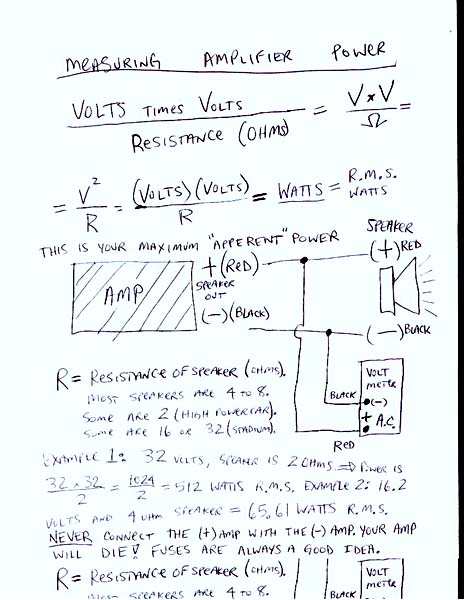

2.Then sound amplifier red (+OUT) to AMPERE A.C. multimeter red (+IN) to AMPERE A.C. multimeter black (-IN) to loudspeaker red (+IN).
Click here to see a setup diagram
