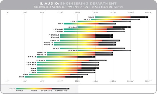

welcome to amplifier clipping. you fried your own sub.
turn the gain on the amplifier down next time.
also, 500 watts for a JL 12W7 is ideal. Go much higher and you void the warranty by overpowering it.
Look at the JL recommended power chart.

^^^ Yeah the power chart was what I was refering to Glass. But, as soon as he said he was only using a 500w RF, I knew he was clipping the hell out of that thing! lol

isnt the 12W7 supposed to take 1000 watts easily??
Username: J_baby15
Kentucky
Post Number: 597
13w7^^^Like Glass said, the JL chart says 500 is ideal....too much voids their warranty.

the optimum is actually closer to 800wRMS...but you could have still fried it with a 500wRMS amp.:-(
