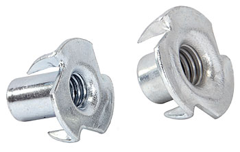

Saturday, September 09, 2006 - 19:13 GMT I use what is called a T nut...thats what they are called....u drill a hole then stick this thing one the backside then I just used bolts to hold it down...its bassically a nut with some things on the front so that it can hold into the wood. here is a pic of it.

Saturday, September 09, 2006 - 19:45 GMT where can i buy these? i can see how these t nuts would be better than just wood screws, but do you think its really necessary? atleast for me? im installing 12 AA arsenals

Saturday, September 09, 2006 - 20:02 GMT you can get those at home depot. thats where i bought mine. i don't know if its necessary but i like to use them cause i know it guarantees a tight mount.

Saturday, September 09, 2006 - 20:17 GMT I would say get them....u can get them at any hardware store....they are good becuase you get a good seal and if you have to take the sub for any reason you dont have to worry about messing up the mdf.

Saturday, September 09, 2006 - 22:41 GMT ok i will get them, do you use anything besides the tnuts and the bolt, like washers or anything?

Sunday, September 10, 2006 - 07:30 GMT No nothing but the t nut and then a bolt

Sunday, September 10, 2006 - 09:39 GMT ya those work perfect. its cool, cause you can take sub in and out as many times as you want, and not harm the mdf itself. its worht it. just make sure u get the right screws, with the right thread. like course screw and course tnut.

Sunday, September 10, 2006 - 18:12 GMT screws hold just fine.. the problem is when u start takin screws out and putting them back in it wears the thread that the screw has cut into the wood and eventually it wont hold

Sunday, September 10, 2006 - 18:59 GMT That is very talented peeps, ill start usin those also so i dont make my holes round from taking off and putting on my sub so many times.....

Monday, September 11, 2006 - 03:40 GMT did it earlier today, worked very well, thanks guys, ive learned alot on here, but im still learning
