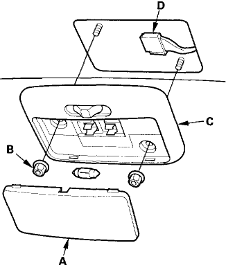

DOME LIGHT BULB, LMFAO....:-O
Username: Jenifer_contreras
Tampa, Florida USA
Post Number: 109
wha wha,this the right name from alldata crash book.
