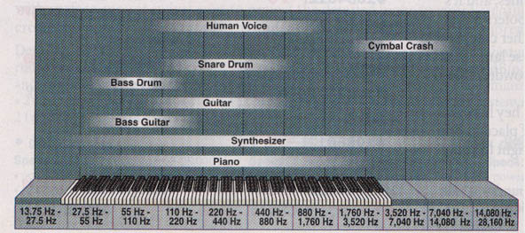

That might help.
Anyway, the sub plays 0-80Hz (theoretically-these numbers used for demonstration only) and the front speakers are supposed to make up for everything else (80-20,000Hz). This could easily turn into a long discussion, but I'll keep it concise.
Stock speakers are supposed to play the 80-20,000Hz, but in reality don't reach that high because they don't normally have a tweeter in them (or any other apparatus allowing them to achieve such high frequencies). If you're looking at speakers, just get some coaxials or components-they include both tweeters and midranges. The sound of only a tweeter or midrange with a sub is going to be hideous...I mean, you'll have a massive gap in the sound spectrum! Look at Focals, CDTs, Infinity Kappas, Dynaudios, Diamond Audios, even Alpine makes good components.
