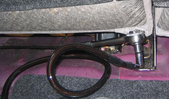

Username: Serius
Miami, FL USA
Post Number: 88
Upload not my car but this was from a DIY same car but different year. the only thing i screwed mine to the black brackit on the back of this pic becuase mine didnt have what he had

Username: Van_man
Boston, MA
Post Number: 256
Try moving to ground. Seat brackets are not the best place for ground. 1 its painted. Did you remove the paint? 2 some use Isolaters to lessen vibrations. to improve ride quality. Did you put a meter to em. DMM can find probs easier than just quessing.
