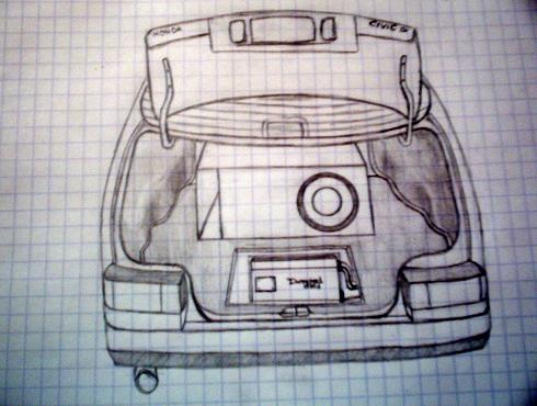

Username: Matt12490
Benicia, California USA
Post Number: 818
Registered: May-05
this is my new plan to do in the summer. sorry if the sketch is a little out of proportion... the trunk looks like a hatch but its a trunk. where the amp is, i plan on covering the whole trunk with a piece of carpeted MDF then cutting a piece out of the middle and putting a piece of plexiglass there. underneath it all is the spare tire well which is pretty big and ill take the tire out and put both of my amps in there. the spare tire well stretches from the front of the trunk all the way to the back. so behind the sub box i will put in 2 fans: 1 to blow air in and 1 to blow air out. well anyways those are my new plans for my trunk and ported box. what do you think?
