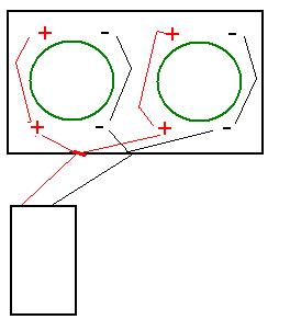

take the nuts off the terminal of one side of your box and take the connectors and put them on the other terminal and connect both subs to that terminal. ill trie to find a picture

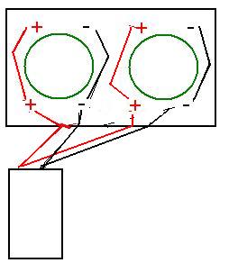

Example A
Example B
Example C
In your situation, any of the three pics I posted here, will give you a final of 1 ohm impedance.

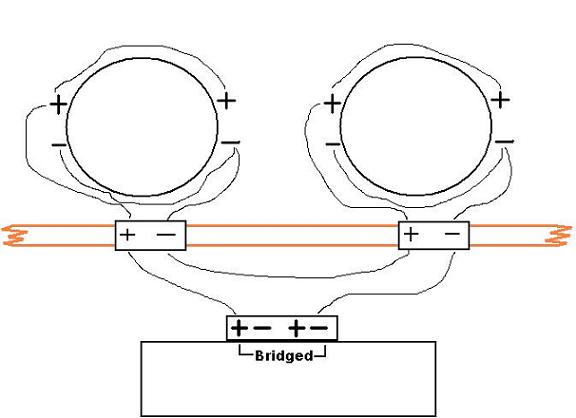

seth, he needs a 4 ohm bridged load for that amp, not 1.
I'd do it something like this...

so optidriven... u basically wire the woofers vc's in parallel, then connect a wire between one plus and minus on the termianl cups(what kind of wire would you use for this?), then connect the plus and minus that are not used to the amp
- what ohm load will this setup give to the amp?
- where did you learn to wire like that?

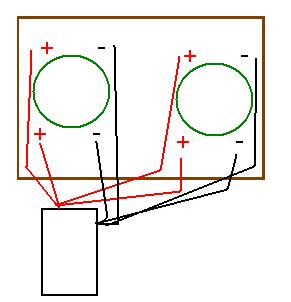

Username: N2audio
Lawrence, Ks USA
Post Number: 846
Registered: Mar-04
uhh - check that - I had it parallel/series - but the load at the amp's the same.
This would be series parallel --
