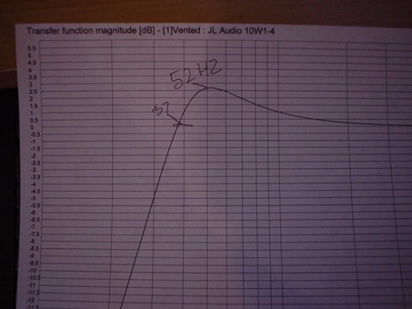

i printed the frequencygraph for the crappy boxUpload

well, like i said i plan on selling it. mArshall, you have a lot of experience building boxes don't you? wouldnt it sound good with a flat line on the frequency chart? BTW i got a pic of the 6.5cft box graph for 2 subs.Upload

those subs would prolly sound pretty crappy in a 6.5cuft vented box. plus, w/ 300w you would be driving them way outside of xmax in a box that big.

WinISD printed that?
