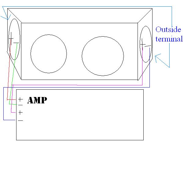

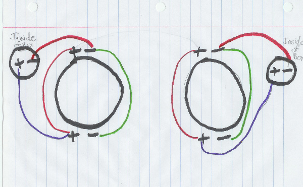

Bronze Member Username: MystrePemberville, Ohio USA Post Number: 53 Registered: Sep-05 | Okay I just hooked up my subs and amp. I am getting no sound. The amp is getting power though. Setup: 2 SPL JWS ( same as JL W6 V1s) 12" DVC 6 Ohm 1 JL Audio 500/1 amp. Below are diagrams of the setup. First one is the outside of the box. The second is of the inside of the box. Any questions, just ask. Thanks. ![]() ![]() |

Bronze Member Username: MystrePemberville, Ohio USA Post Number: 69 Registered: Sep-05 | OK. Figured it out. Something in the wiring. I hooked it up normally and they work fine. Somehow I have wired the parallel/parallel wrong. This happened last time, when I had my Audiobahns(can't believe that I even typed that word). I was trying to run them series/parallel. I will try to get a pic up of my wiring soon. |
