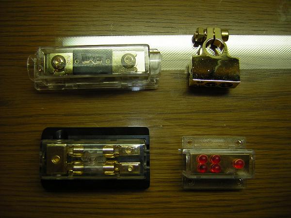

Here are some pieces I got with my amp kit I have no idea what they do and what benefits i can gain with them. I think the one in the top right goes on my battery but for the others im clueless.
Could someone explain to me in detail what the purpose for these are.

on the first picture:
Top left: This is an inline fuse, you wire that into your power cable about 1ft from your battery.
Top right: Battery terminal distro block, you can put this onto your battery terminal if you're connecting several wires. (wiring 2 or 3 amps and other items)
Bottom Left: Fused distro block, if you have to split your wire to two separate amps you would put this before your amps. Run your main power wire (4ga) into one side of this and then you would connect the smaller power wire (8ga) into the other side and put those to your amps.
Bottom Right: Just another distro block, highly doubt its nesseccary for your install...

PS: item placement is from your point of view looking at the screen...

(Top left: This is an inline fuse, you wire that into your power cable about 1ft from your battery.)
^^^ Does it matter if its not 1 ft from the battery? I have mine right by the amp. Is it better to do it by the battery?? Thanx
