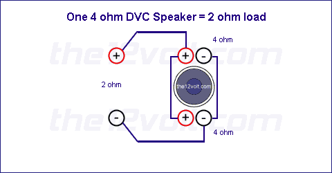

Post Number: 6307
wire each sub like this & run each sub to each terminal
