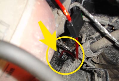

Hey... i know someone has already posted something regarding this but i can't seem to find anywhere on my polo to run my amp cable. I've serach all over the net been to special list and they are saying drill it but i'm a real amature and trying to save a few ££'s...
CAN ANY BODY HELP....
surely polo's must have some grommets somewhere??????

If you look closely on the firewall there will be a VERY LARGE rubber boot/gromet looking thing with a lot of wires going through it. You may need to get underneith. When you locate it look to see if there is any extra room so that you can put a small hole in it large enough for your cable. Be sure to make a hole smaller than the dia of your cable so it will seal by itself. I have heard of others just running it along the frame rail and such but I myself prefer to keep it inside. Make sure you add an inline fuese no more than 14" from the battery, Polo..

i just did that...what i did was there was a grommet in the fire wall where the headlight wires went inside the car so i made a little hole in it with a exacto knife and pushed my power threw it and it came out around the pedals then hid it under the carpet and sealed the hole up with some calking

Hey... thanks for all ya help. i've finally managed to get the wire through the gromet and inside the car.
