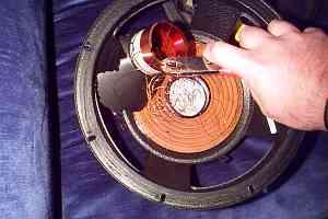

WHOA.. hehe you need to do some major research...
the Red thing... thats the voice coil... it's like and electric magnet.. when electricity flows around the coil it pulls toward the MAgnet... or pushes away.. they are usually made of tinsel or aluminum.. and on cheaper subs they are just glued to the cone... others are in a molded spindle.. molded spindles are so much more reliable and accurate.. brands like Dual, Sony, Pyramid, Pyle.. ect just spool the voice coil right on the cone and cover it with glue.. so the voice coils melt the glue.. than the voice coil gets loose and it goes haywire... just like in the Pcture on the left... the wavy thing is the spider... it looks like a web... it keeps the spool centered..
on the pic on the right youl see a hole on the center of the spider... the soice coil slips in that little crack..
webUploadUpload
