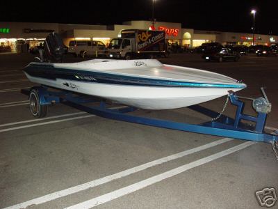

what kinda boat????

Post Number: 233
lol i was expecting a wakeboarding boat....what is that like 18 feet???? what size engine????? i'm sure you have plenty of room up front for a amp or is that closed off????

Its 19 foot with a Mariner 220HP souped up a little. runs about 96mph

yah, lol, there should be somewhere nice and sealed you can put it....maybe...that is a small boat/i'm sure it doesn't have a helluva lot of storage space....
