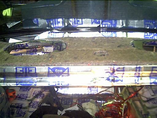

my car better not rattle i did the whole car in fat mat trunk lid, trunk, floor, roof, sides an doors an its all on the metal cause i used the roller hope it dosnt rattle iam goin 2 test it when i get the trunk done

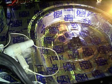

Username: Shadylimitedx
Pgh, Pa Usa
Post Number: 522
Registered: Apr-05

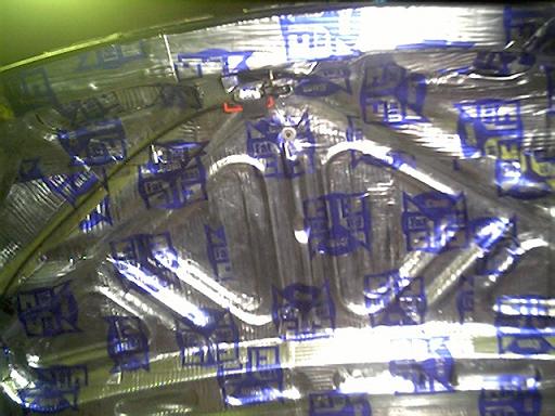

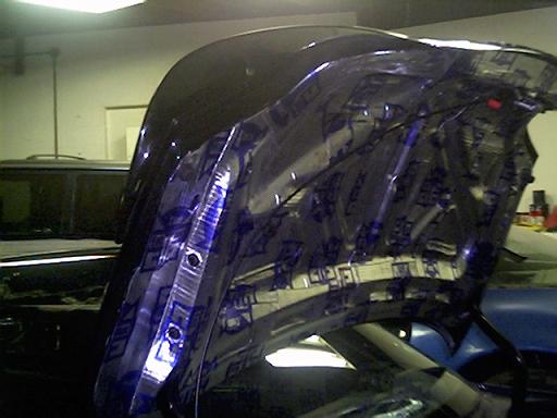

Pgh, Pa Usa
Post Number: 523
Registered: Apr-05
Username: Insearchofbass
Post Number: 4559
nice work scott

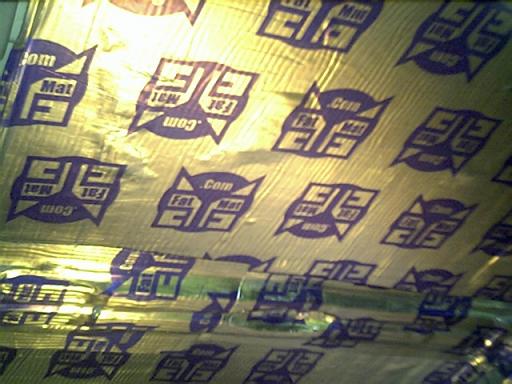

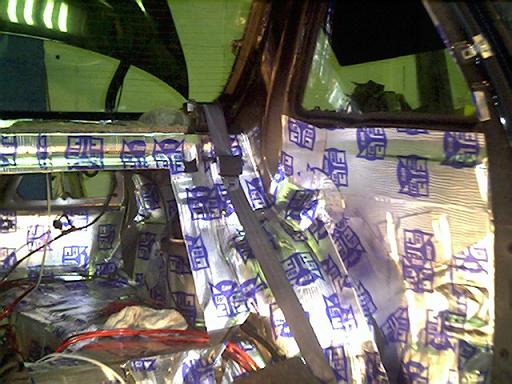

Pgh, Pa Usa
Post Number: 524
Registered: Apr-05

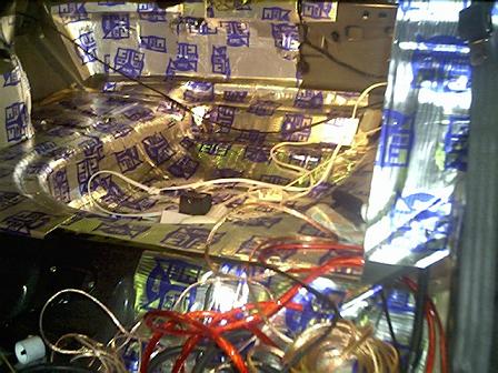

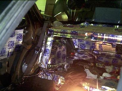

Pgh, Pa Usa
Post Number: 525
Registered: Apr-05
tolk a month so far but i havnt been doin it every day tho an its cold an it sucks lol so u think my bass b nice lol
Post Number: 4560
should definately help the sound quality and hopefully spl
