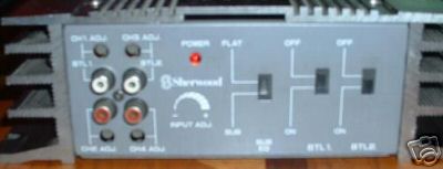

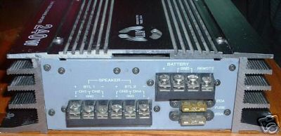

these are pictures of the inputs and the speaker conections. i have the right and left inputs from the x-over going to the 2 top inputs on the amp labeled blt.1 & blt.2. the switch is on sub and the other 2 switches are set to on. i have the speakers bridged according to the diagram of the speaker set up. its sound good for about 5 minutes then it shuts off.

why does that amp have two terminals for the gnd? and is your gain set too high? juss trying to help , anyone no what the problem might be.
