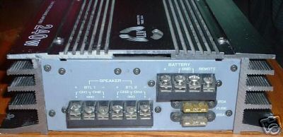

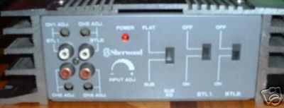

HELP, amp keeps cutting off!!!!!!! Have 2 pics, PLEASE HELP!!!!!!!
Username: Mrmoe75
Post Number: 22
Registered: Aug-05
these are pictures of the inputs and the speaker conections. i have the right and left inputs from the x-over going to the 2 top inputs on the amp labeled blt.1 & blt.2. the switch is on sub and the other 2 switches are set to on. i have the speakers bridged according to the diagram of the speaker set up. its sound good for about 5 minutes then it shuts off.

what are the specs for that amp bridged, it may be that your ohm load is to much, i would assume that if you do not have a single 4 ohm sub on each bridged channel, or dual 2 ohm that, it is prob the porblem.

IT IS 60x4 OR 120x2 BOTH A 4 OHM LOADS. BOTH SUBS ARE SINGLE 4OHM SUB ON BOTH BRIDGED CHANNELS.

make sure that for each sub, the speaker pos+ wire is connected to the left channel pos+ terminal on the amp, and the neg- speaker wire of the sub is connected to the right neg- terminal on the amp. Set the filter on the amp to lowpass or sub.
