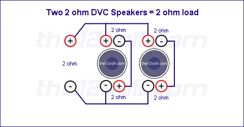

jhm1198 Unregistered guest | heres what I did from the apline diagram the jumpers are placed in the middle of each sub which are +,- and then i ran + to + and - to - which is then running to the amp and is wired according to the parallel way the amp instructs. did i do this right?, so i should be running at 2 ohms correct? maybe i need to work with it and tune it better. Thanks for your help. |
Gold Member Username: RovinTrinidad & T... Post Number: 4183 Registered: Jul-05 | most importantly note that amp is overrated & even if u wire into 2ohms u will not be getting 1100wrms like they said , prolly about 75% estimated = 825 825 / 2 = 412.5 or roughly that amt but it should still make ur subs bump - so do check over wiring ... u should have them wired like this ![]() also don't overlook how good or lack of good ur box is made .......... |
