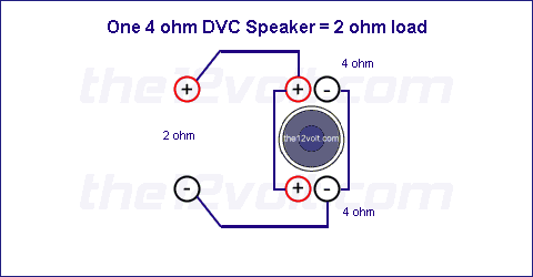

Username: 225
H-Town, PA USA
Post Number: 25
Okay so this is how I wired the sub. It came with two banana plugs.
i put one going from positive to positive
and the other
from negative to negative.
then i took the speaker wire and put one in with the banana plug in the positive and one in the banana plug in the negative and ran it out.
this would give me a 2 ohm load right?
Username: Rovin
Trinidad & T...
Post Number: 3905
if u did it like this then yea
