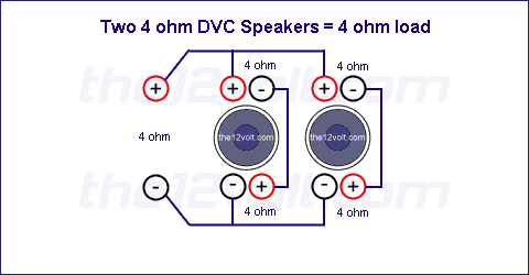

I have 2 subs DVC4 ohms wired to get a 4 ohm load on the amplifier. It is currently running stereo (it is a Kicker 450.2 amp). I tried reversing the positive on 1 channel with the positive on the other channel. I also tried combining both positives and putting them on the first channels positive terminal and combining both negatives and putting them on channel 2's negative terminal. All of them result it in the amp going into protect at about 2/3 volume! What is the correct way of changing it from stereo to mono. Thanks

using the 2 subs connected like this
if u use the + off the 1st chan & the - off the 2nd channel,,,,do u not hear anything ?...

yup they are hooked up exactly like that. If I hook it up how you said nothing comes out.

first of all you are going to get either a 2ohm load or 8ohm load per sub, run those a 2ohm stereo, do not worry about bridging it.
