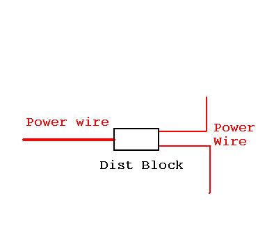

Silver Member Username: FandimReno, Nevada United State... Post Number: 416 Registered: Jun-05 | Tyler it's pretty simple.. here is a little diagram. ![]() |
Silver Member Username: TdbdadrummerPost Number: 634 Registered: Aug-05 | Where do you put the Dist. block? Also, would a split 4 awg wire work? That's about all I can get around here...And is that the power wire from the wiring kit connected to the battery? And what about the remote wire, is it ok to run two of them from the back of the HU? |

Silver Member Username: FandimReno, Nevada United State... Post Number: 418 Registered: Jun-05 | Tyler, to be on the safe side, you should upgrade your wiring to 0 gauge, especially if it's going to be longer than 10 feet or so. Also, the distribution block can pretty much go anywhere..just place it in-line. Then you can use an inline fuse holder, or even just get a fused distribution block if you'd prefer, to make things nice and safe.. (I personally dont fuse after every distribution block, I know I should, though...better safe than sorry I guess.) 180 amps should be plenty to push that load.. To figure out how many watts you can pull, figure amps x volts = watts. And remember - your cars electrical system already uses up a good chunk of what the stock alternator can produce.. So you have to account for that. In the little diagram, yes, that's the power wire from the battery. About your remote wire question. You can run two wires from the back, yes. However, you could also simply run the wire to one of your amps, then run a wire from that terminal, to the remote terminal of your other amp, as well. With only two amps, this shouldnt present any real problem, however, if you ever add more in the future, you're going to need to get a relay, so you dont pull too much from the remote output on your deck.. (it's not meant to put out very much at ALL.) What a relay does, is basically, when it's turned on, it completes a circuit for an alternate power source to travel through.. So you can hook your remote wire up to the relay, then hook up a 12v power source (i.e. line from battery) to it, and a ground wire to it, then you'll have a connection on it where, when your remote wire is activated and turns it on, you'll have a 12 volt power supply that wont blow the remote output on your deck. But like I said...with just two amps, you're going to be ok just using the remote wire. The reason I'd recomend either using a little dist block, the wire from your first amp terminal, or even just an in-line wire splicer, however, is so you dont have the full two lengths of wire running from your remote out, so instead of having 28 feet of wire (14 average x 2), you'd just have like 16-18 feet. (14 going back, then however far your amps are apart.) Seth |
