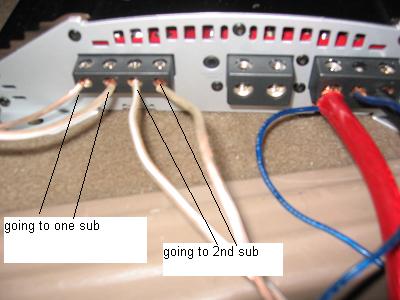

hey guys i will be running my 2 re sx with orion 2500d. Can any one please tell me how to wire them to get the best results
my subs are 2ohms so i guess the max i can get is 1700 rms
this is the picture of what i did ,
is this the only way to wire this? or can i use + from left and negative from right . will this give more power? or should i use + and - for both subs from one hook?

thats right, some mono amps have 2 + and 2 - to make it easier to wire subs, also if your subs are 2ohm u can wire them to a 1 ohm load

Hold on, are your subs 2ohms DVC or SVC? Depending on the VCs, you could blow the amp. Orion 2500D is I believe, 1ohm stable. So make sure it doesn't fall below that.

Then depending on your VC wiring, it can be 2ohms total or .5ohms. If it's the 2nd one, then the amp will overload.

Sx's only come in DVC...and unless you special ordered them, they are DVC 2ohm.
wire them in series parrallel...this will give you a 2ohm load.

hey guys, i think something happend to my amp i tried running old subwoofers with it just to make sure if the problem was with the re sx or something else. But the old subwoofers are also making the same noice "tuck tuck tuck" no sound is comming. My amp was working fine with the old subs before i tried the re sx.
can any one please tell me what might have happend, and what should i do now

You might have wired it wrong to your SX and blew the amp. If you think you wired everything correctly and you didn't make any mistakes, maybe you need to go get the amp tested. Also, are you running the 2 powers and 2 ground like I said?

This is how i wired the subs.
well first i was running 3 infinity kappas on it before i got re sx. infinities were SVC so all i did was connect amp + to sub + and amp - to sub -. The amp was working fine with the above wiring. Now for re sx. i did exactly the same thing. i connected pos to pos and neg to neg. Only used one svc and it didnt work, So after that i wired to both ports used *(dvc).
and it still didnt work. Can this messup the amp ?
what should i do now :-(

Straight from the manual:
The Orion 2500d has two seperate four gauge power and ground inputs. Both pairs must use 4 AWG power wire for proper operation. Failure to do this may damage the amplifier and is not covered under warranty.
So basically you either damaged it with that or when you wired your sub, you wired it to too low of a resistance.
You probably need a good amount of electrical knowledge to fix whatever's broken. You have to figure out what's broken first.

i think you are right, i wired the subs to a very low resistance.
if i wired the subs like
+ from amp to subs + and - from amp to subs - . Only used svc didnt wire to dvc.
this is what did with both of my subs
what resistance is this ?
how else should i have wired them ?

Tjat should've worked if they're both DVC 2 ohm subs. I means that you wired one voice coil one each sub to the amp and should bring it down to 1ohm. If you wired both voice coils on both subs up to the amp in parallel like you said then you wired it to .5ohm; thus frying your amp. Next time try only hooking up one SX - and hook one voice coil up to each terminal on the amp. Keep the gain fairly low. DO NOT TURN IT WAY UP OR YOU WILL BLOW YOUR SUB GIVING IT 2500W. Only turn it up enough to test it. The most you can get out of that amp to both subs is 850wrms per sub (that is if the amp puts out 1700wrms at 2ohm). You shoulda got the 4ohm DVC SX's...

hey bro thankx for repling. First time i only hooked one voice coil on each sub, so it was total of 1 ohm for both subs and i remember the gains were all the way down :-( Still this shyt happend. Also the place where i bought this from , they said its can go down to .5 ohm for daily use and it should work fine.
