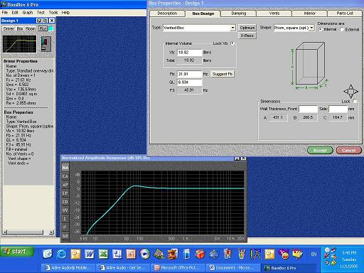

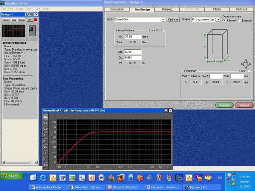

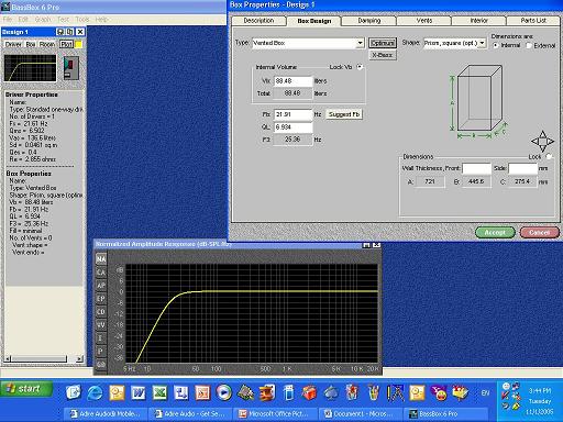

Silver Member Username: MixneffectOrangevale, Ca. USA Post Number: 458 Registered: Apr-05 | For the record; Let me explain. Sealed boxes require a much larger box compared to a ported box, due to the fact that a ported box produces a lower frequency cutoff than a sealed box. Thus a sealed box requires a larger box than a ported box when you try to get the same FO. In other words; comparing apples to apples. It doesn't matter if a manufacturer recommends their driver to be used in a sealed box in a much smaller enclosure compared to a ported enclosure if the FO is off by 20-40 Hz. The main reason for an enclosure is to allow the driver to reproduce larger wavelengths. A sealed box is limited to how large of a wavelength it can reproduce. A ported box will reproduce the same wavelength using a smaller box. Some drivers will not reproduce the same wavelength in a sealed box compared to a ported box, no matter how big you make the sealed box. So, to make a better comparison; let's make the ported box small enough so that it has the same FO as a sealed box. Now compare the volumes. Red = Sealed Yellow = ported Blue = ported undersized to match sealed FO ![]() ![]() ![]() ![]() |

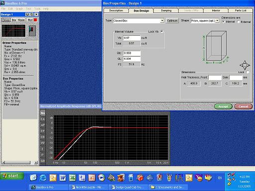

Silver Member Username: MixneffectOrangevale, Ca. USA Post Number: 460 Registered: Apr-05 | Sealed; VB=1.32 cubic foot QTC=.707 QL=6.934 F3=45.91 Hz Ported; VB=3.125 cubic foot FB=21.91 Hz QL=6.934 F3=25.36 Hz Ported to match Sealed FO; VB= .668 cubic foot FB=21.91 Hz QL=6.934 F3=45.91 Hz Sealed using the MUSIC MOOSE ENCLOSURE VB= .57 cubic foot QTC=.959 QL=6.934 F3=51.9 Hz ![]() Red=optimum sealed White=Music Moose .57 cf box So Eric N; You may use the Music Moose box, but you will only get down to 51.9 Hz |

Bronze Member Username: SuicideshifterBristolville, Ohio United States Post Number: 92 Registered: Jul-04 | Mixneffect, how many watts should i run to them to drive them to full xmax? and u say that i'll only get down to 51.9 Hz...does that mean it's not going to slam as hard in this box? |

Silver Member Username: MixneffectOrangevale, Ca. USA Post Number: 468 Registered: Apr-05 | Run them at full power. Whatever RMS is. i am at work now and dont have all the programs or websites saved in my favorites so ... An FO of 52 Hz doesnt mean it will not hit hard or not. It just means that it will not reproduce the lows. 60 Hz is ok for bass. 40 Hz is verry verry good. 30 Hz is exceptional. 20 Hz is almost hard to find. You are at 52Hz. This means that in that particular box it will reproduce 52 Hz at 3 dB below par. You will still be able to hear 40 Hz, just not as loud. |

Silver Member Username: MixneffectOrangevale, Ca. USA Post Number: 469 Registered: Apr-05 | Michael; Car audio drivers are usually designed with a high Qts. This is to allow them to be used in sealed enclosures or infinite baffles. These types of drivers are usually more powerfull/robust compared to home audio drivers. Some better SQ car audio drivers are now designed with lower Qts, so it is becoming more common nowadays. Never-the-less, look into what Qts does and/or is used for. Eric, I have a better graph for your setup. I just couldn't post it last night due to technical difficulties. If you like your drivers, and wanna use that box, it wont be a problem. It will not reproduce below 40 Hz, thats all. |
