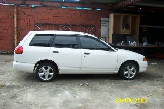

Hatchbacks will be louder for the reasons as u said above - thats why 1 of the considerations was music when i was choosing my ride to be bought .
so thats why i picked this wagon Upload
trunk is almost 4ft wide & 3ft deep , with seats down its almost 6ft deep !

Nice ride. What is it? I never seen that b4
Yea. Hatches Hitttttt
Username: Rovin
Trinidad & T...
Post Number: 1636
Click on my profile - none ever landed in the US but REALLY popular over here & its not expensive ,around 40gs TT$ foreign used .
