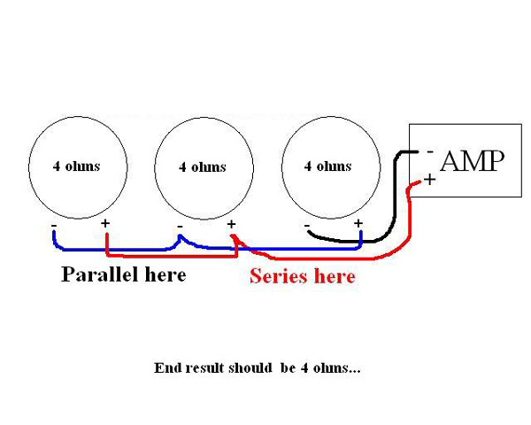

This may work but let some of the other people here look at my diagram and decide...Upload

That does not look right.... I wouldn't try it.

Hi again do you have the 1500-XXK? If you do then it is a stereo amp and is stable at 2ohms x 2 so you can wire them in the way you sugested. 1 channel will be at 4ohms while the other channel will be at 2ohms (if connected in parallel) The sound level will not be even between the three subs though, the 4ohm will be quieter than the other 2. Really to be honest I would highly recommend a 1ohm stable amp...Orion 1200D is a good example OR I would buy one more coustic sub and wire each channel at 2 ohms.

I am wondering what this would result in ohms wise...Glasswolf or anyone who really knows their stuff...let me know.
