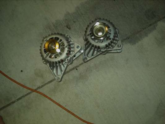

It's not lack of current. And the box is very large, built into the hatch of my firebird, and yes, it's slot ported. (built by a JL authorized dealer). My alt is 200 amps, 14.4v. It's not like cancellation..I mean the bass almost totally stops, and gets very muddy what little is heard...it's very odd.

Not sure why you assumed I didnt have a HO alternator.. :-) lol. Running a pair of 0 gauge back, one going to a 20 farad capacitor, then a 4 gauge from that, to my PG amp (and another 4 guage going to the dist block that my 2nd 0 gauge splits at) my other 0 gauge, is going to a dist block, then from there, a 4 gauge going to the other input on my PG amp, a 4 gauge going to the hifonics, and a 4 gauge going to my 4way amp.. (MB Quartz midbass, RF tweeters frontstage, pioneer REV series 2way rear quarter panels). 0 gauge wire from engine/chasis, batt/chasis, and alt/bat.

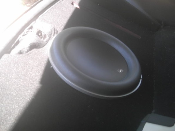

Well, not built into it...but lays down into it, and the sucker is heavy as hell, but not perma attached or anything..just a pain in the butt to get to the wiring. :-)

Jon, the W7 is in a custom box that lays down into the cargo area beneath my hatch. The mic will be attached to my front windshield, passenger side. I have a shitload of edead on the entire surface of the car, except for ceiling, (as you can see in the pics I posted), and am using a Phoenix Gold Xenon 1200 watt RMS amp (pushes 1200 RMS anywhere from 1-4 ohms, CEA rated).
