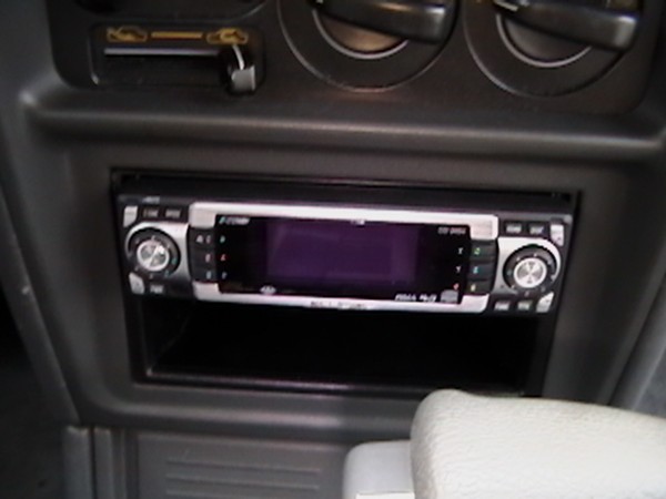

My HU is the Eclipse CD8454 and ive been playing around with it on easy mode and pro mode.
Pro mode gives me more options as far as crossovers for each driver etc...
Can you help me EQ my highs mids and lows..

Yeah my headunit has a PEQ feature in promode which is the parametric eq. Its designed for 3 way systems with subs or 4 speakers and subs from what ive read. Im new to Eclipse CD8454 so i need some help EQing this. I have it set in pro mode now. I have the crossover for the low pass filter at 80hz with a 12db slope. I have the high pass filter set at i think 100 or 125 with a 12db slope. Not really good at this stuff.

As far as the PEQ function, you connect the microphone to the AUX jack lead from the head unit, and you go into PEQ mode. Hold the display button in for a couple of seconds and you'll hear white noise. Make sure your car is parked, in a quiet environment (no cars passing with horns honking, etc.), and then do the test. Set your time alignment, crossovers prior to doing this. Place the microphone where you will sit at (or just clip it to your hat, shirt, etc., it's not really that loud). Once it finishes, it'll show the curve, and you can keep adjusting and rerunning the noise (same method, display button) to see how your adjustments did. This isn't the most accurate out there, but it's a big step from what it was before. Just a note, if you turn the head unit off and have been in Pro mode, then start it up again, for some reason the Auto-EQ won't read (it will display Vol up, or Vol down). If you go back to easy mode, and then back to pro mode and try again, it works just fine. Just a quirk I ran across a while back, might not be the case in yours.

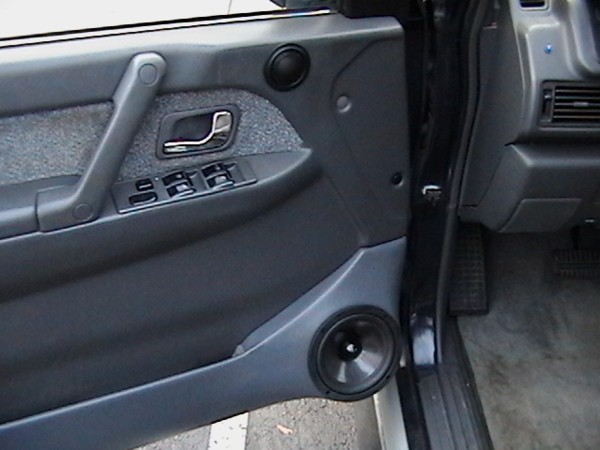

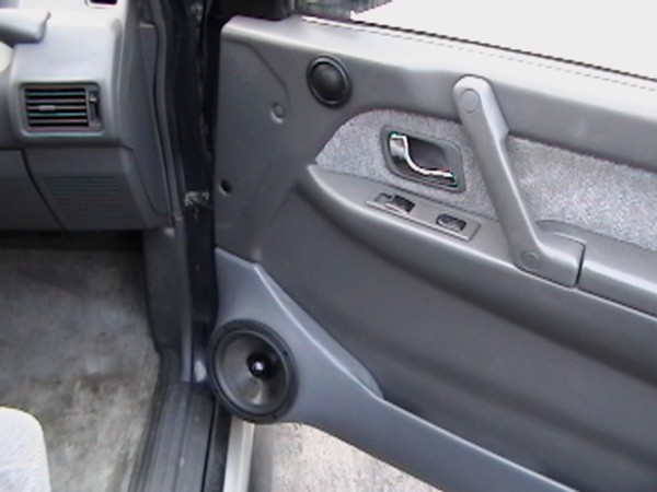

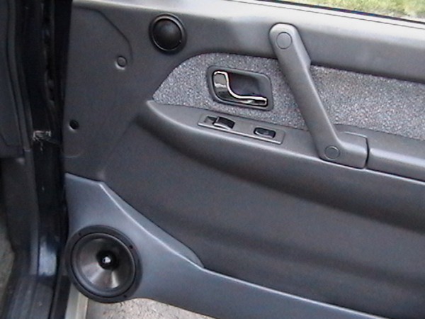

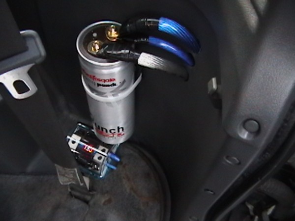

Here are the install pictures i took today.

Nice install, BTW.

I couldnt find a place to plug in the microphone for the auto eq and if its behind the unit then i wont worry about it. So far it sounds very good. What does the SVC option do ?

"I couldnt find a place to plug in the microphone for the auto eq and if its behind the unit then i wont worry about it. So far it sounds very good. What does the SVC option do ?"
Yeah, it's behind the head unit. SVC is source volume control, you can set different sources (CD, Mem stick, etc) to have a certain level so there aren't radical changes in volume level when you swap to FM or whatever. Waste of time, IMO.

MO, I think the PPI is 4v max. Nice install. Have you thought of getting/making a rack for the amps and moving it away from the floor?
It'll also help hide the amps from wandering eyes.

lol Mo clean your carpet dont be lazy. That is a very good install what kind of speakers you have for your doors they look pretty big.

Clint from Alabama... they are image dynamics CXS62 Chamoleon componants. They are the best componants iv ever heard and yes they are monsters and are 7" or so. Very strong midbass and very clear and loud silk dome tweeter.
Isaac... I was referring to the CrossFire sub amp that i have. I have the gain set to halfway mark and it sounds fine there for now. I am pleased with the install overall and decided to mount the amps on the floor because i can still fold those cargo seats down over the amps and remove the sub box along with it on any long trips with alot of people in my car.
Only thing left is to find a speaker grill for my componants on the door. Anybody know of any places to find a fitting speaker grill?

Also..I tested my electrical system last night by parking by a wall and had my system up and i had no signs of dimming lights at all. My voltage read 13.8 on the digital dist block the whole time with slight .1 drops once in a while. I have optima yellowtop under the hood and that 1 farad cap. Im pleased at how my stock electrical system is working. I already have a 180A HO alternator on the way from excessiveamperage and i dont even see any signs that i need one.. Lol Oh well better for future upgrades i guess.
