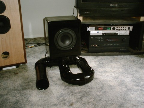

yes you can heres an example and keep in mind you can get more creative with looks and conversion technics using outside port ideas...heres a picUpload
Username: Insearchofbass
Post Number: 3432
coversion technics like swappable ports and sealed plates ...i made a joke once on this subject about making header pipes using this approach ...if you were using one sub you could make one functional and the rest nonfunctional to create the appearance you want and you could paint the pipes or use whatever material you wanted heck how bout a mock up motor with those pipes lol ps...as you said you could also port into a cab or up through a deck depending on your project goals this is without the header pipe idea used of course hehe

that is awesome...i never knew that you could hvae them come out that much...so if you needed approx 16 inches of port, you could have a few inches stinking out if you couldnt fit it all in the enclosure?
Post Number: 3433
you dont even need the port to go inside more than the wood thickness if you wanted
