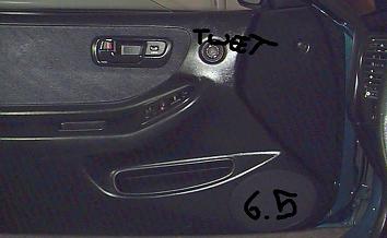

I had suggested that to my friend, and he said sense my mirriors are motorized that that's where all the electronics are for them, and it would be pretty hard to put it in there? So I guess the worst place to put is where they already are, in the door? lol
I know for Utopia's it really depends on the install, so I appreciate all the ideas. Also need to be ina place I'd imagine where there would be good dampening.

yeah, the door sails. i agree. although imaging will still be suboptimal as opposed to the previous suggestions. i run my highs in the sails as well (and they sound good),
but in retrospect i would have rather stuck to the above locations. its considerably less expensive but i had my pods custom built anyway, so i have no excuse. the installer deviated from my initial instructions b/c it was easier for him.

The Utopia's IMO seem to easier to find at a lower price because of how many there are compared to the Iridiums. Honestly I don't know what I'm after but yet I do. I'm looking for somethign that sounds great and would I imagine have a good mid cause I'd like the bass balance in rap when the subs are pounding in the back. I like SQ and that means Clarity and those Utopia's were amazing clarity. I drive a 98 integra coupe GS. the door with tweeter looks like this.
Would this position be fine? or just test it?
Also with the install, I would think you jus put the mids were the factory mids were and the tweeter where the old tweeter was and there you have a good soudning system? or am i very wrong? is it worth the effort? Now I'm thinking about getting some Hertz HX 2 12's for the back. Focal subs are hard to find on the net and quite expensive retail. Plus i want SQL not just SQ. Hear the Hertz will give me what of what I'll want, but then again that's what hte local retail guy says on what he carries. W3 or 6 sound better'er?
