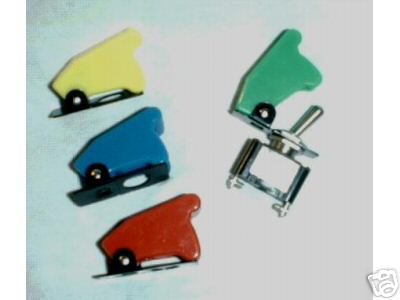

Sure, just hook up a switch to the remote wire of the amp. You can use any type, though I would prefer this kind (metal toggle switch with aircraft flip cover):
They also come in black. Then again, you might want a switch that doesn't stick out and blends with the car's interior. It's up to you.
