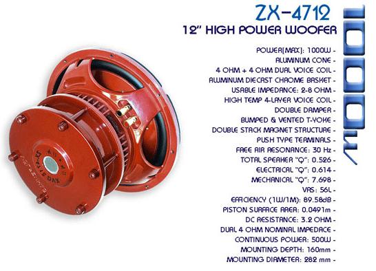

I have volfenhag 12' 1000W peak and sony xplode 600w amp
amp says 500W but mine is 600w
http://www.bestbuy.com/site/olspage.jsp?skuId=6254849&type=product&productCategoryId=cat03085&id=1072285993791Upload

How do you have the voice coils wired? It looks like a DVC and you very easily could have wired it down to 2 ohms. And i'm fairly sure Sony amps can't handle that. What is the model number on the Sony amp?
