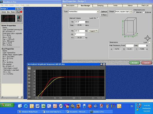

Gold Member Username: InsearchofbassPost Number: 3235 Registered: Jun-04 | i didnt use winisd beta i used my own program but im glad you found the right specs mixneffect |

Gold Member Username: InsearchofbassPost Number: 3241 Registered: Jun-04 | im lost wether what i did was with the right specs now cuz im confused which theil small mixneffect is saying is right. |
Silver Member Username: MixneffectOrangevale, Ca. USA Post Number: 196 Registered: Apr-05 | The last graph pic is with the specs in post #14 by Knacko. Just scroll up. These specs are allow for a 2.5 cf sealed box. |

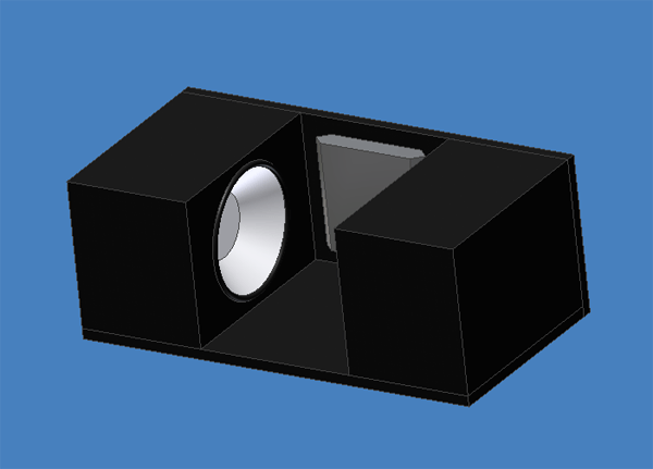

Bronze Member Username: RichierchPost Number: 43 Registered: Jun-05 | this is the first box ive ever designed and/or made(havent made it yet)...is 3/4" MDF good for the material |
Silver Member Username: MixneffectOrangevale, Ca. USA Post Number: 207 Registered: Apr-05 | Its ok for low power applications. I recommend 1" MDF for better sound, or if you plan on thumping that thing. It cost like $30-40 a sheet for the 1", compared to $20-25 a sheet for 3/4". If you go with 1", the outside dimmensions will change. |
Bronze Member Username: RichierchPost Number: 48 Registered: Jun-05 | i know and i only have a 39" opening and the box i designed is in there but i will look at it tonight and i can probably keep the outside dimensions the same and make the insides smaller and maybe get to the 1.136 talk to you later |

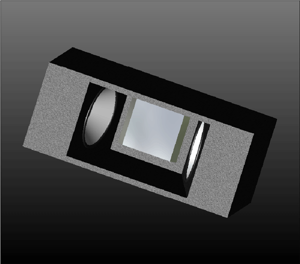

Bronze Member Username: RichierchPost Number: 50 Registered: Jun-05 | well here is what i had to change the box to because im pretty sure with 1" MDF the slant box just wont work out in the area i need it to be ![]() |
Bronze Member Username: RichierchPost Number: 52 Registered: Jun-05 | new dimensions internal height: 12" - depth: 10" - width: 17" volume: 1.181 sq. in. |
Silver Member Username: MixneffectOrangevale, Ca. USA Post Number: 215 Registered: Apr-05 | Are there two woofers in this box, or just one? If its just one, then why is there a space in between the two chambers? |
Silver Member Username: MixneffectOrangevale, Ca. USA Post Number: 216 Registered: Apr-05 | Letto, Here are your graphs: Yellow is sealed .468 Cu Ft / 13.24 Liters. Frequency cutoff is 59.37 Hz. (15.07" X 9.314" X 7.566") These are INTERNAL DIMMENSIONS. Red is ported 1.037 Cu Ft / 29.37 Liters. Tuning frequency is 28.13 Hz. Cutoff frequency is 34.28 Hz. Port is 2" X 8.729". (19.78" X 12.23" X 7.566") These are INTERNAL DIMMENSIONS. ![]() |
Bronze Member Username: RichierchPost Number: 55 Registered: Jun-05 | the thing in the middle is the amp and there are two subs |
Bronze Member Username: RichierchPost Number: 56 Registered: Jun-05 | hey mix can you run these dimensions for the box Internal: height-13 depth-14 width-12 volume - 1.263 sq in ![]() |
Bronze Member Username: RichierchPost Number: 57 Registered: Jun-05 | thats with 1" MDF i really liked the wedge box i made but it was with 3/4" MDF |
