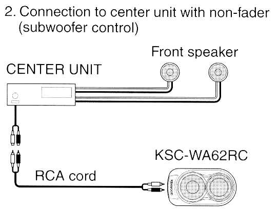

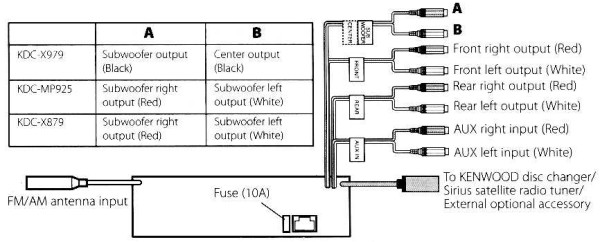

OK, I recently purchased a Kenwood KSC-WA62RC powered subwoofer to connect to my Kenwood KDC-X979 head unit.
The sub wants to be connected to Sub out left and Sub out right. The head unit only has one sub out and a center channel out.
Should I only connect the one sub out to it or should I use the center channel out for the other sub input?

Here are scans from the manuals

I think that's what I may have to do. I went through the head unit manuals and found that the center channel is on a High pass filter, so it won't pass anything below 250hz.

When the manual says sub out left and sub out right it is simply describing the single RCA sub cable you already have which consists of a left and a right channel. So in essence, you only need to hook up one RCA cable-preferably the sub out one.
Username: Ehostler
VA
That's not what the diagrams show. The sub has 2 physical RCA inputs and the head unit only has the one RCA sub output.
In any case, I bought an RCA Y-cable and put it in at the sub and then a 12' cable from the Y to the sub out of the head unit.
All appears good. The sub does have a high crackling off of it. The sub uses an active speaker and a passive cone. The passive cone is producing the crackle. Looks like I may be exchangeing the unit...
