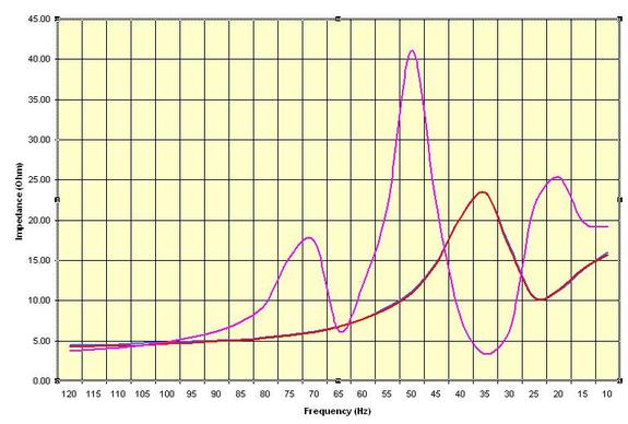

Username: Insearchofbass
Post Number: 3056
Heres the impedance chart if you wanna compare my spl results with his readings in the same box...but I just realized I had my selective tone button on when i did these readings on the subs its basically a bass boost and tweeter boost so keep than in mind...the reciever is an onkyo 424
Post Number: 3057
i think with my triple chamber abc i can get rid of that impedance hump and that woulld add alot of spl and smooth out the sound even better
