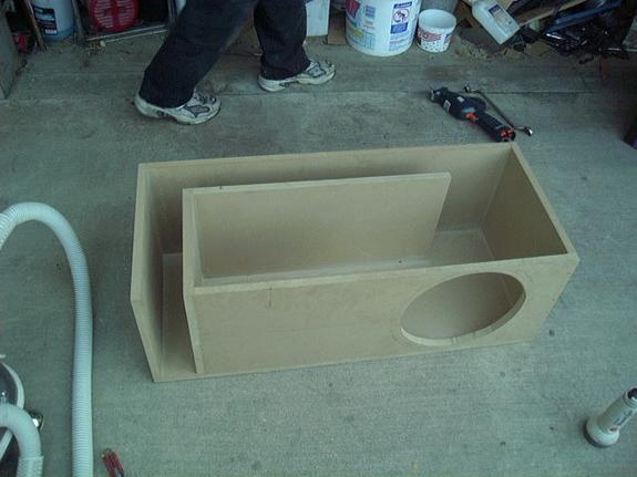

Im making a box for an orion h2 15" 4 ohm. Should i make the box 2.5 cubic feet with a port length of 16.8 inches tuned at 32 hz or should i make a bigger box say perhaps 3 or 4 cubic feet. Size isnt really much of an issue seeing as how im putting it in the back of my blazer with the seat folded down. What should i do PLEASE HELP!! Maybe a box like this one i seen possibly? Upload
