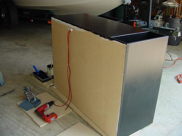

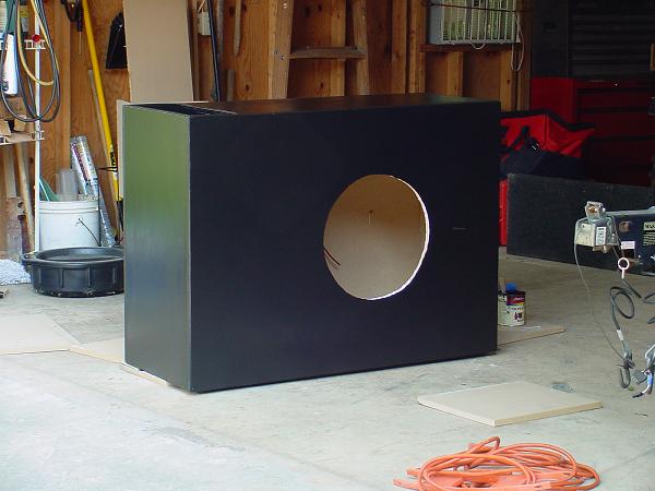

here is the box i built for my avalanche it is tuned to 26.11hz and is 13.232^3ft. 2 more coats of paint and im done with it and that is 10gauge wire going into the box.Upload

That's a nice coat of paint and sweet job on getting that hole cut out so perfectly.

rotozips work wonders :-)

man alpine thats a "BIG" box lol just wondering "unless i didnt see it" why didnt u put any bracing inside?? those are big stretches of 3/4 mdf or do u think the port will relieve most of the pressure?? looks good tho even with the type of paint used ...i wouldnt wanna be in the car when u crank that up lol.. I should show u a pick of my type r box i used the duplicolor automotive paint and it matched the color of the cones exactly which was pretty cool... friggin expensive pain tho :\

what are your demensions internally for your box alpine? and what are the demensions of your port? I assume your using .75 mdf. Nice box by the way.

yea, you may want to add some kind of bracing inside that box, as stated, those are long streatchs of MDF and they will resonate with that sub.
If you dont want to change the internal volume, use threaded rod.

also why didnt you use terminal cups?

i do have bracing you just cant see it and the reason i dont use terminal cups is for the fact that the cups dont conduct the voltage as well as the copper wire does. I'll have to hunt for the box dimensions i cant seem to find them but as for the port its 7"W x 17.5"T x 27"D.
