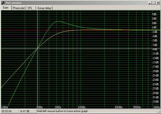

After a certain point it will. Ported boxes roll off at a rate of 24db/oct below their tuned frequency (It will be 24db quieter the next octave down, which in the case of 39hz, that will be at 19.5hz), while sealed boxes roll off at a rate of 12db/oct below their resonant frequency (It will be 12db quieter an octave down, and since sealed boxes usually resonate around 40-50hz in most enclosures, that will be around 20-25hz). Cabin gain of the vehicle helps compensate for the rolloff of both of these enclosures, but that doesn't matter in this case as the vehicle is a constant in the comparison. If you had a ported box tuned at 39hz, and the same sub in a sealed box with a .707Qtc (average size sealed box), then the sealed would begin to get louder around high 20s in frequency and anything below that. That is generalized as sealed enclosures vary in their resonance depending on the driver used and the size of the enclosure. Subs in most sealed boxes resonate around 40-50hz.

Here's a graph to simulate what Jonathan and I said (Yellow is sealed and Green is ported):
Sorry for the crappy quality, it took me about 8 seconds in Paint to do.

So my box tuned to 39hz, which plays the lowest frequencies hardly as loud as (im guessing) frequencies around the port tune, will still play the lowest frequencies louder than if it were in a sealed box?
