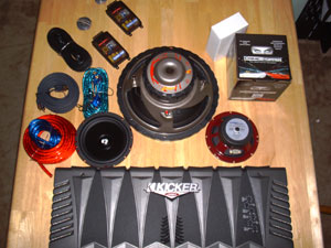

Bronze Member Username: Steveo?????, CA USA Post Number: 13 Registered: Mar-04 | New system coming together... -Kicker 800.4 amp -Kicker CompVR 12" sub -Set of CDT CL-61a 6.5" components -4 gauge pwr wire -RCAs -(Alpine 9813 on its way) QUESTION: If I buy a set of CDTs for rear fill, can I run the sub and both sets of components at 2ohm? Or would the sub continue to be 4ohm and the CDTs to 2ohm hence a 100W to each component speaker and 400W to sub? More specifically can the amp run at different ohm loads on the chnls? Or must the amp be run completely at 2ohm, or completely at 4ohm. With my setup (+ a set of CDT Mids), can I run everyting including sub at 2ohm? Am I looking to far into this 2ohm thing? As always, any advice is greatly appreciated! Thanks in advance, SteveO ![]() |
Bronze Member Username: N2audioLawrence, Ks USA Post Number: 19 Registered: Mar-04 | Yes, you're fine. It will be fine with 2 ch at 2 ohms stereo and the other 2 bridged to 4 ohms. Electrically 4 ohms mono and 2 ohms stereo is the same load on the amp anyway. |
