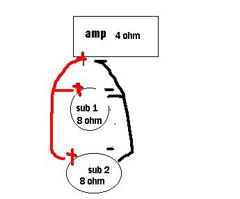

Is this how to wire to subs in parallel?
Will both subs get 100w rms or will the first get slightly more because of the resistence would be less?

The reason I'm asking this question is because all the diagrams out there explain parallel wiring more like this:
The first sub is a 12w0 with two terminals per terminal. So would I just hook the first sub up like in a single sub setup then hook the second sub upto the other set of terminals on the 12w0?
