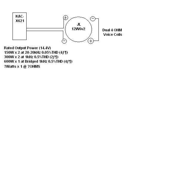

I was just wondering; if I am using a 12W6v2 (DVC 4OHM) and a KAC-X621 bridged, what ohm would this configuration eqivilate to and is this even feasible?

Thats 300 x 1 into 8 ohms.
The amp's not stable 2 ohm bridged. You could run both subs in parallel off ONE amp with the voice coils in series(like in your pic).
That would save some space, but you're still only going to be running 300 watts to each sub. It'll probably sound a lot cleaner with two amps however.
If you want more power to those subs I'd consider selling those Kenwoods and investing in say one good 800-1000 watt monoblock that gets full power at either 1 or 4 ohms or one bigger two channel.
