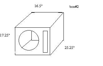

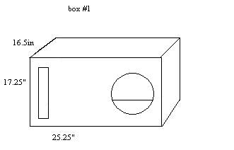

i was just wondering if changing box dimensions really changed anything... for example..
if you have a box like box 1... and you changed it to box 2... would anything change?

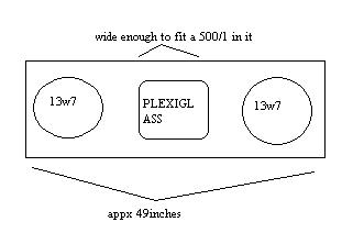

what im getting at is i have 49 inches accross in the back of the truck... i want 2 13s in their own box but i only want to use appx. 32 inches across so an amp can fit in the middle of the 2 boxes... im also trying to stick with JLs specifications... the sealed box works just fine but im trying to see if i can do ported... i dont want the box to be higher than 22niches deeper than 28inches or wider than 16.5 inches each box... total of appx 32inches..

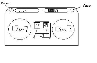

what im lookin to build is around sumin like this... if the box is around 17-18 inches tall i would put the amps (the 2 1000/1s) slanted on top of the box under plexiglass... if the box is taller i would put them angled below the box...

Trevor, there would be a difference since the port in box number 2 would be longer than the port in box number 1.

heres another picture of my "dream" inside the plexiglass the thing thats not labeled is 2 battries
also the sides of the sub boxes are going to be plexiglass so you can see the motor through the 2 pieces of plexiglass

so the length of the port inside the box has alot to do with the sound too? .. i thought maybe it just had to do with the lenths like 2 inch by 15 inch (where you can see) i didnt know that you had to add in the factor of how deep the port went... thanks joe

yes the port length and width is the most important thing in building a ported box . that is how you tune it to a certain frequency.. if u build a box tuned to 32 hz the infrasonic filter on your amp is set to 32 hz and that will be the most effective frequency area for the sub...there are a few port calculators on the internet to make it easier for u though because the size of the port will vary depending on how big the box is and what drivers are in the box..
