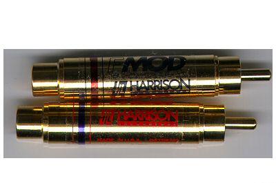

Correction, their called Harrison Labs, lol. Here's a pic of what they look like.

What the heck, my post moved, lol. Don't ask me how they work, but they do, I have a pair.

SS boxes are variants of a transmission line enclosure, typically with 1/4 wave theory, so you'd set the subsonic filter 1/4 octave down from the resonant frequency (Fs) of the subwoofer. In the case of that Ti, around 20 hz would work fine. Harrison Labs F-Mods will work for that. About ported boxes and such, they don't instantly lose damping the second you go below the tuned frequency, they gradually lose damping, and eventually you'll get to a point in which the sub performs as if it were mounted infinite baffle.
