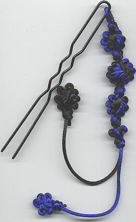

New member Username: N30Post Number: 6 Registered: 02-2004 | People who don't like to experiment a little and think you should have some knowledge of what you are doing piss me off. I discovered the following to be true on my own. ....did you know, in a pinch you can use an old fashioned hair pin in lieu of a 15amp fuse? I conducted this simple test myself and can attest that the pin will not permit 15 amps of current past, however I am not sure at what amperage the pin broke the circuit. You can repeat this test to verify my findings only after you have read and understand the instructions below. First, obtain a hair pin similar to the one pictured below. Next, find an electrical outlet in your home on a 15 amp circuit. Now spread the pin apart to match the width of the holes in the outlet (ignore the ground hole). Now grasp the pin firmly in the palm of your hand and insert it into the outlet. The test was successful if: 1. The pin melted without tripping the circuit breaker. 2. You now have a cauterized imprint of the pin in the palm of your hand. 3. You wake up, hopefully, at some point in the near future with an incredibly agonizing pain emanating from your hand realizing that #2 above is true. The test was not successful if: 1. You are dead. 2. You stand there being shocked until your teeth begin to crumble and the severely painful muscle spasms cause you to disconnect from the outlet or someone not realizing this a test, picks up a large piece of non-conducting furniture and knocks you down which in itself may result in #1. (Please note: If either of these should occur, the test has not been completed and you may or may not elect to repeat the test procedure). 3. You have chosen to utilize the commonly accepted method to protect circuits despite the fact that the hair pin method may work fine if properly executed and may not cause overloads, house fires, catastrophic equipment failures, etc. As I stated, I actually conducted this test with a hair pin I found and all successful test criteria were met. One other minor point, but I feel compelled to mention this. I was 3 years old at the time and still remember waking up in the hospital asking my dad if I was going to die. Needless to say, I didn't but learned to have a healthy respect for things electric just by a little experimentation. |

New member Username: N30Post Number: 7 Registered: 02-2004 | LOL...now thats the best method yet fortyamps, especially the lager! |
