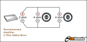

no richard your wrong. if they are dvc 4 ohms and there is 2 of them, they will be either 4 ohms in series or 1 ohm in parallell. but since he has 2 single 4 ohm subs, he can wire them like...
this way you can get a 2 ohm load with both subs

How loud a system is has more to do with how a sub is wired and the type of box it's in and a few other things. With single voice coils @4ohms and two subs wired in parallel your get a 2ohms load. The most you can get is 600 watts RMS x 1 at 2 ohms. Remember two sub that's 300 watts each.
Single voice coil subs @4ohms with two subs can be wired @ 2 ohms or 8 ohms to one channel only.
Dual voice coil subs @4ohms with two subs can be wired @ 1ohms or 4 ohms to one channel only.
